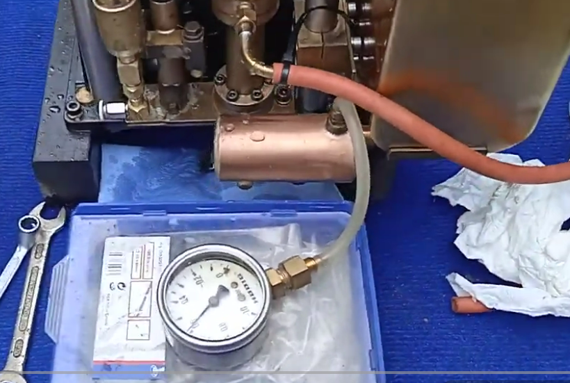

The photo shows the vacuum achieved during the test of my large steam engine with hand-tightened connections.

I'll probably do it the same way as on my large steam engine. There, the condensate flows into a collection container and is then pumped out using a condensate pump.

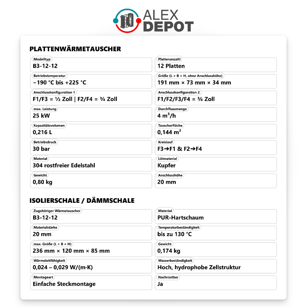

That flat plate heat exchanger looks quite interesting; they are very compact for the surface area provided. How does one choose the appropriate size of unit to avoid excessive back presure?

I used the smallest heat exchanger I could find. Because the exhaust steam is completely condensed and the condensate is then pumped out, no back pressure is expected. At least that wasn't the case with the condenser of my large steam engine. I will take advantage of a meeting in May and then conduct tests on the loaded machine.
Some more data can be found here.
