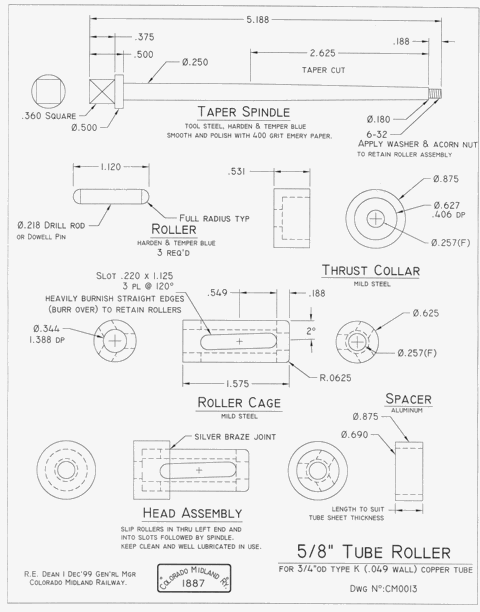

I borrowed a Friend's commercial tube roller to fit the 5/8" coper flues on my locomotive boiler.
Hand powered it to prevent over-rolling of the tubes.
Here is a drawing showing a tube roller you can make.
A more comprehensive article appeared in Live Steam Magazine, November/December 2003.
I am unable to attach .pdf files here, probably because I am ignorant of that process!
Otherwise, I could attached the article itself.
flue Roller5-8.gif (32.85 KiB) Viewed 29542 times
Re: VFT tube leak
Note that the drawing shows a roller guide slot that is not aligned with the centerline of the guide, thus this is a self feeding tube expander. My commercial expander, for 1-1/4 OD x 0.095 wall boiler tubes is not configured this way.

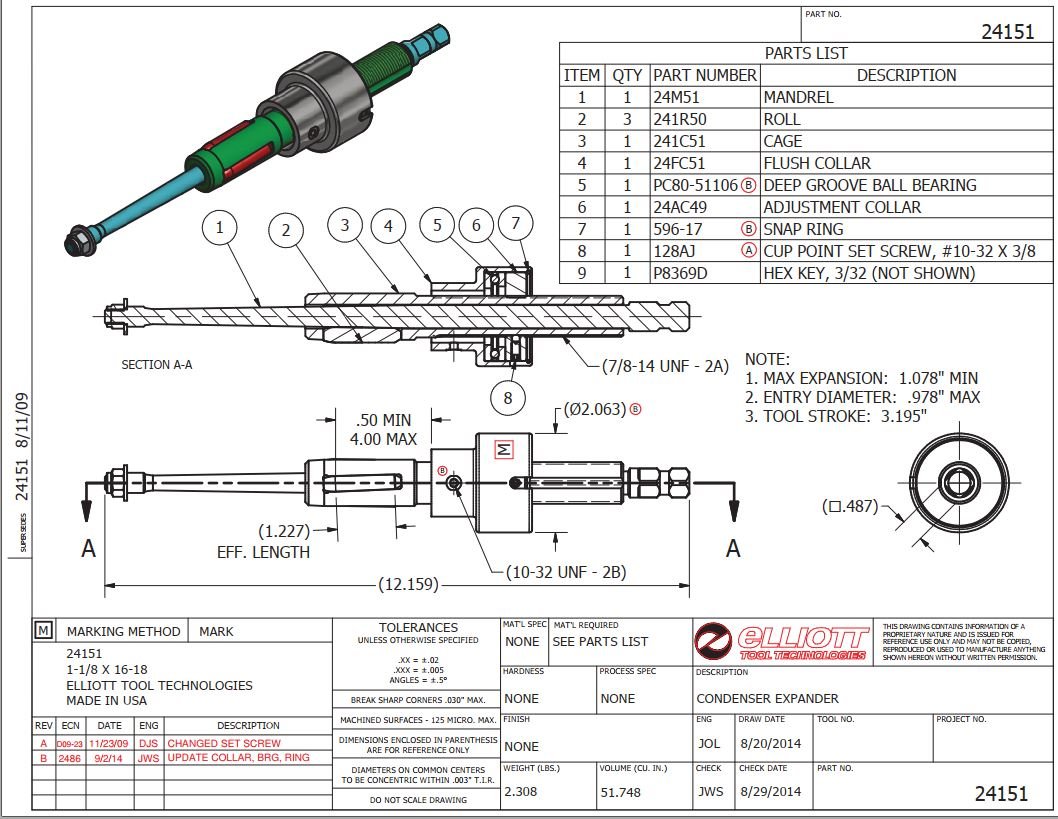

I have purchased this tool from Elliot tool 320$
I am concerned about sanding the ID of the tube smooth enough for the roller. I have purchased one of those ball tip hones that look like a brush to use after I brush the tube ID.
Thanks for the help
I will report the progress
