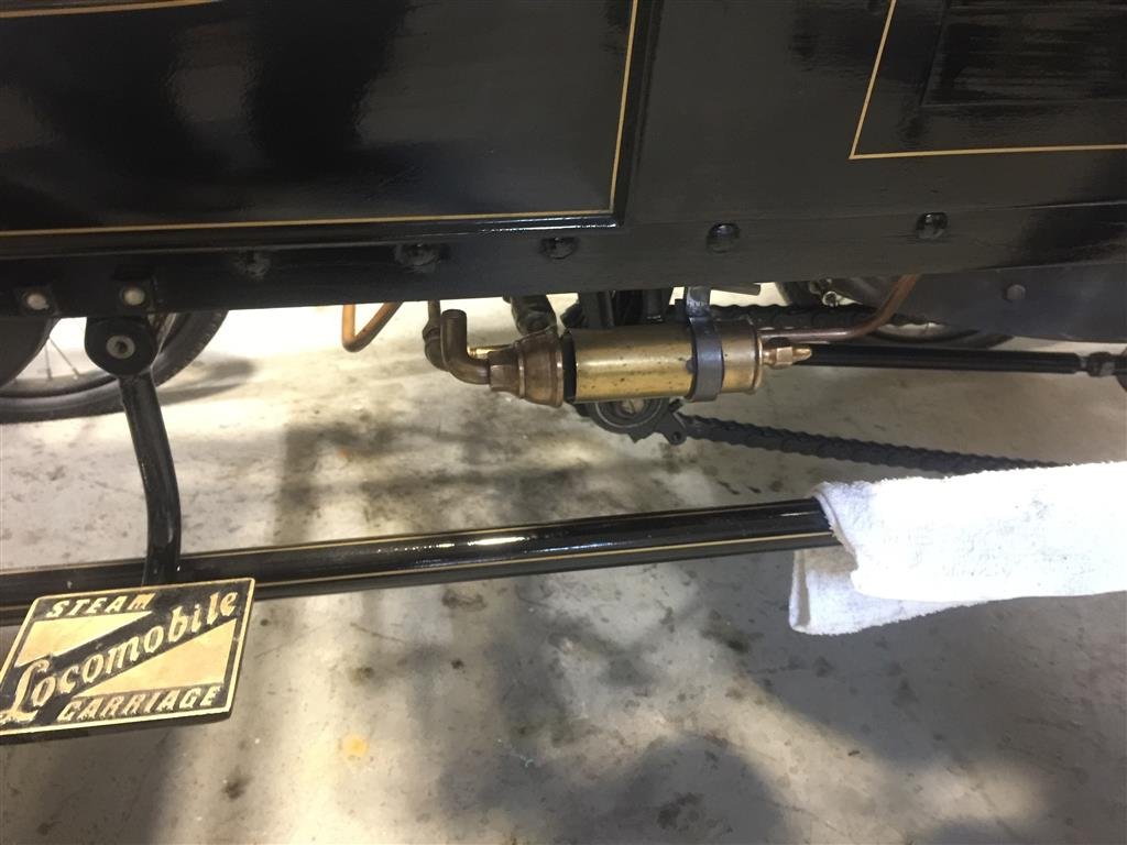

Quote: "I'm contemplating small bypass line with a needle valve from just before the whistle valve back to the hot well to keep the whistle feed line from accumulating condensation. I don't expect it to totally eliminate the hot water shower but one hopes."
That is a common problem I've ran across. A shot of water at the beginning is condensation, but if it is blowing water after one second or so, that is a case of the whistle being too large for the boiler. High demand/violent boiling/rising water level and carry over. I've seen this remedied by simply downsizing the piping to the whistle i.e. instead of half inch pipe, using 3/8" copper tube instead. This limits the amount of steam going to the whistle, it may not be as loud, but it's better than being scalded.
I have an original whistle from a steam launch, it's on my Locomobile car of all places. It is a 3 chime, 1-3/8" diameter body with 1/4" pipe, the elbow at the base suggests that it's steam line ran inside the stack (which would combat the condensation issue by keeping the line hot). The whistles that modern day steamboaters are using were for traction engines etc, much larger boilers. Just a sidenote, the steam cars never had whistles as they would scare horses. When in Rome..
- IMG_1539 (Medium).JPG (96.6 KiB) Viewed 7098 times
