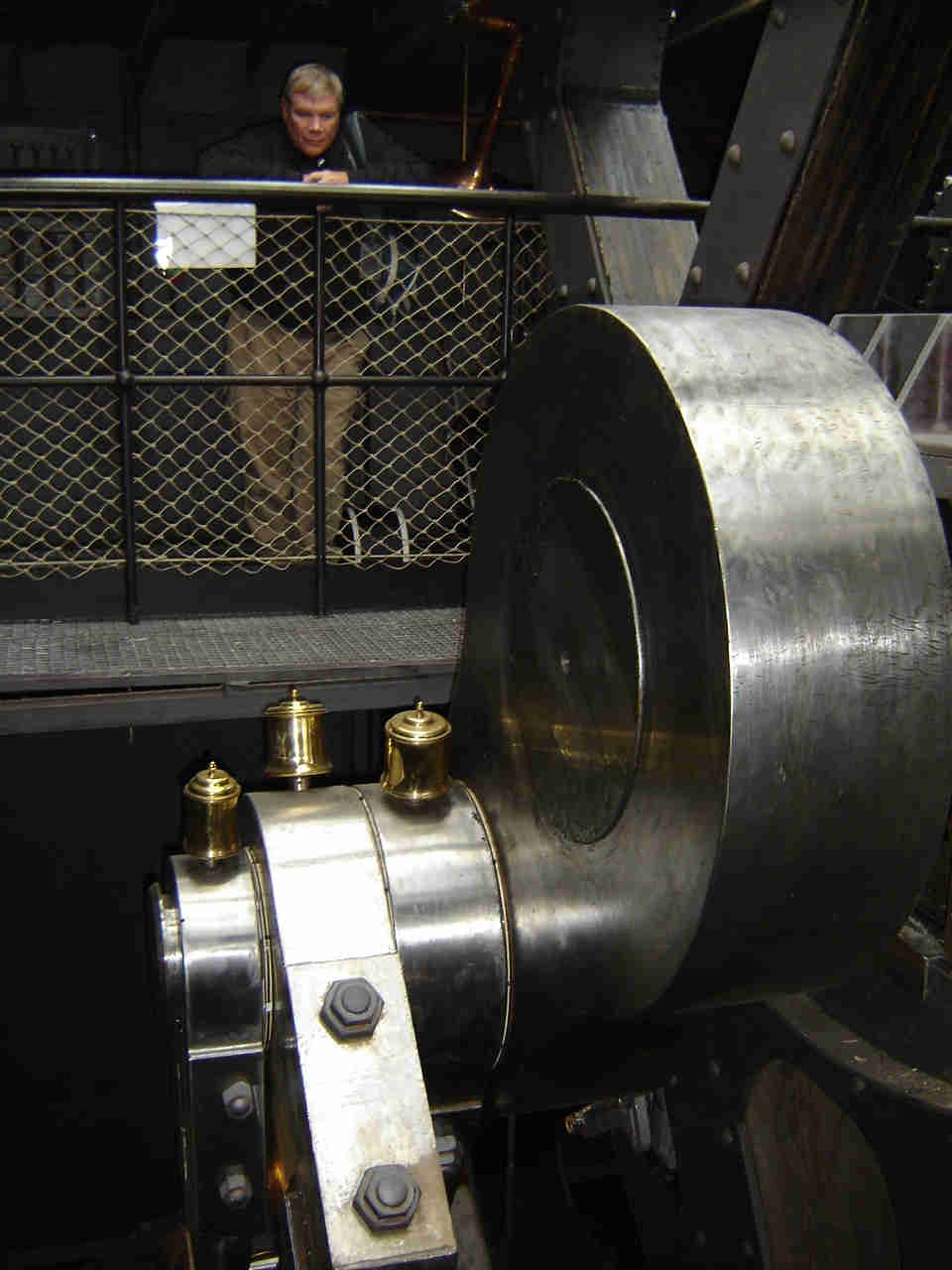

"Gearbox:
You're very clear about the gearbox Fred. I do share your opinion! In 2014 however I visited the "Great Brittain", believed to be the first propellordriven oceangoing ship in the world. As drewling around in this magnificent work of art I ran into this gigantic multiple chain used as a gearbox..."
I made a trip to the UK just for steam machinery review, and the Great Brittian was at the top of the list. This ship is arguably the most important historical ship in the world, was the largest ship in the world at the time it was built, and was novel in having iron construction, and steam primary propulsion, with a screw propeller. Its original engine was designed as a paddlewheel engine, so very low RPM and the need to have the big chain drive gearing arrangement. While it was not the first use of screw propellers, nor the first iron ship, nor the first steamer, it was indeed the first integration of many revolutionary ship technologies on a large scale. Perhaps even more impressive: it had enough integrity, at 140 years of age, to be recovered from half way around the world, brought back to Bristol in the 1970s, and floated on its own hull up the river into its original building dock. The restoration work is excellent. However on visiting the steam engines at Crossness (in London), I went into a trance that I still have not recovered from, so be cautious if you visit the Crossness Station when it is steaming!
"propelloraxleangle" = propeller shaft angle
Attached picture, crankshaft in Great Brittan main engine.
Sorry to be "off-topic" somewhat, but interesting subject for steam people.
