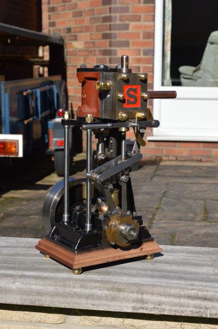

Well today the proof was supposed to be in the pudding. Unfortunately only 50% of it was. Having got the last of the pieces back on I HAD to try it on air. The 50% bit is that it runs fairly well forwards but doesn't run properly in reverse, there must still be a bit of valve tweaking to do. I left the slide length 'as was' and tried for the best setting I could get. I managed to get it to open and close in more or less the right places, but it never sees a full inlet port, in fact not much more than about half.
S.Turner 5a (27) (450 x 677).jpg (73.57 KiB) Viewed 11878 times
No laughing at its plinth, it had to have something to keep the flywheel off the deck. Well that's my excuse anyway.
Late Edit
Gave it a rest for a while and then added some steam oil to the valve chest. Now it runs both ways and has run for about half an hour. It is getting noticeably more powerful and smoother running, and using less air. I think the valves will still need a small tweak, but only a touch.

The detail of what has been done is that, there were no proper cylinder cover, or steam-chest, studs. Obvious from first glance.
On removing the steam-chest cover there was no valve-slide or locking nuts. :roll:
On removing the cylinder there were no rings. :roll: :roll:
On checking the eccentric straps they were loose, and when tightened they bound up solid. :roll: :roll: :roll:
On checking the big-end, it too was loose, and when tightened bound up. On further checking the shells weren't round, but stepped. (either orientation). :roll: :roll: :roll: :roll:
On checking the small-end, the gudgeon (wrist) pin was too tight and the bush had to be reamed. :roll: :roll: :roll: :roll: :roll:
On checking the crank shaft there were various drillings for oil-ways left open ended, and no continuous oil feed gallery for the big-end. :roll: :roll: :roll: :roll: :roll: :roll:
On checking the main bearings they too needed a touch or two with a reamer to allow free rotation. :roll: :roll: :roll: :roll: :roll: :roll: :roll:
On re-assembly the cross-head guide needed re-aligning and adjusting, The eccentrics and valve rod were miss-aligned, and there was no method of locking the eccentric settings. The valve rod was too long. There was no suitable gland on the valve rod (now "O" ringed) and none at all on the piston rod (now, good old, graphite yarn). :roll: :roll: :roll: :roll: :roll: :roll: :roll: :roll:
It has to be said, it wouldn't have been too much more trouble to have started afresh, when all the cleaning up and re-painting is taken into account; but a quite enjoyable project all the same.

That's a nice looking engine. Yes, any partial build always has it's maladies.
On the eccentric strap, I've found they need to be "ran in". If one machines them with no clearance, they may spin freely but will soon become loose when the high spots wear down. That is how mine were. After I ran it for 40-50 hours, I pulled the caps and drug their faces on a file and kept checking for clearance. I've gotten them too tight doing that. Put some thread locker on the bolts and adjust them up where they will spin and keep them oiled. They will eventually wear in and the strap can be tightened fully. It seems after this initial run in if they are kept lubricated they stay tight and do not readily develop clearance again - mine haven't anyway. Apparently all surfaces are now contacting.
On steam engines one shouldn't be too hypersensitive about fit. Comparing them to IC engines (which is where most of us cut teeth on engine mechanics) which are a totally different animal, the steam engine will be quite happy with tolerances for years that would render an IC engine inoperable in seconds. Tightening your components and them being too tight may have been for the purpose of "running in", by the original builder. Of course the "stepped" bores were probably not intentional and probably the result of a dull or too long - too much cut on a boring bar.
Re: Stuart 5a hybrid?
Posted: Sat Mar 08, 2014 11:00 pm
by Mike Rometer
Them's good thoughts Ron! The straps are still inclined to run a touch hot after the initial hour or so of running, so I don't think I got 'em too loose. It's running even better and with much less air today.
I got the impression that it had never got as far as having been got ready to run, merely 'made' with the 'fettling' left and never attempted. I'll run it some more and then re-adjust the valves, see if I can get it to run near even both ways.
