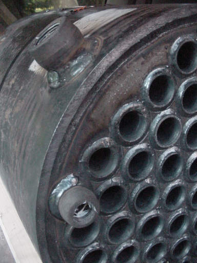

A heavy steel forging for welding onto a pressure vessel is named a "Thread-o-let" or a "Weld-o-let" The threadolet is what we use, it has female pipe threads for screwing on piping. A weldolet is similar, but it has no threads, just a socket to insert pipe, which is then welded in place.

To be honest, I have bought a lot of Schedule 80 female to female couplers, cut them in half and used them with no repercussions beyond some shuddering from a couple of friends. Just make sure you bevel them for full penetration as per proper welding practice.

If you want to do it according to code, use a-105 Thread-o-lets. If you are building (or repairing) a non-code boiler, schedule 80 female couplings cut in half (or "half-couplings" as they are sold already short) are OK for many applications. The short "half couplings" are to be used to attach connections to atmospheric tanks etc.
As Mike stated: An important part of this is to have "full penetration" welds between the thread-o-let, (or the coupling) and the pressure vessel. That is done by having a bevel machined or ground on the welding surface, about 45 degrees. AND having the connection held about 1/8 inch away from the pressure vessel before welding. This gap is required. If welding rods more than 1/8 inch diameter are used, then the gap should be at least as much as the welding rod diameter.
Do not use MIG to put a pressure vessel or its connections together , stick welding is the way to go, unless you have fancy welding equipment that would be found in a pressure vessel factory or similar.

I agree on the Thread-o-lets being a better choice. I suggest the Schedule 80 stuff just because it can sometimes be hard to find the right thing when you live in the sticks. I've cleaned out the local 'old time' hardware store more than once just finding Sched. 80 nipples. And that is in a small industrial fishing town.
It is worth the time and money to have a certified pressure vessel welder do the work and ask to watch for a while. I tack things together for convenience and then have all the rest done by an expert.
First thing is, as Fred says, is the bevel and the spacing. Then, what they call the 'root weld' is done with TiG. All weld starting and stopping points are ground clean so that there are no inclusions and, in the case of a long weld going around a large cylinder like a firetube boiler shell, the weld is done in short segments spaced equally around the circumference. After the root weld is done, out comes the 7018 rod. Same thing about grinding out the starts and stops and doing it in equally spaced segments.

I couldn't find thread-o-lets nearby at the time so i ended up making my own on the lathe from solid bar. I beveled them made them slip into the tank a bit and welded them with the mig using fluxcore wire. I hope it's ok, it,s been 2 years and a few hydro tests to 175psi. Safety is at 125 and i normally run at 75-80.
