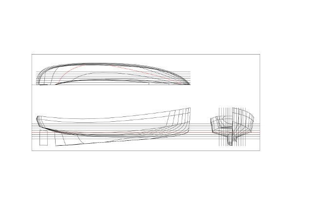

My brother designs boats (along with other things); his website is http://smaalders.net/yacht_design/. He's doing the design for the hull; here's an initial proposed sketch of the lines, including a box keel to facilitate beaching (nice to be able to do in the San Juans):
Sea Lion draft lines_Dec 2012.jpg (18.67 KiB) Viewed 10442 times
. I've got copies of Skene's Elements of Yacht Design and David Gerr's Propeller Handbook here, so running the basic numbers is not difficult. We're going to emphasize efficient performance at 6 - 7 knots; burning two or three times the fuel to go 8 or 9 is fun at a steamboat meet, but for longer distances quite impractical. I want to take this boat all over the Northwest via water, so living aboard in comfort is an important part of the design.
Posts: 1925
Re: Designing a new engine for a big(ger) boat...
Nice hull you have worked up, looks like a comfortable and seaworthy hull.
