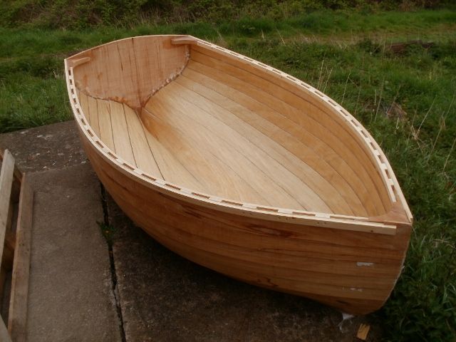

In January this year I started building my own boat, the hull is 7'3" LOA by 4' beam of my own design and is pretty much finished.

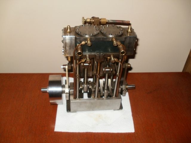

I bought an engine of eBay, it is 1 1/2" + 1 1/2" X 1 1/2" twin.

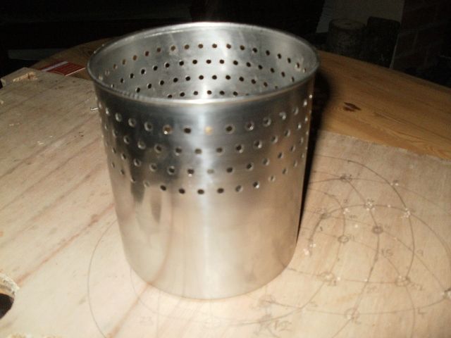

At the moment I am working on the monotube boiler. I have made a stainless steel pot burner from a mug and hope to burn waste vegetable oil or old engine oil.

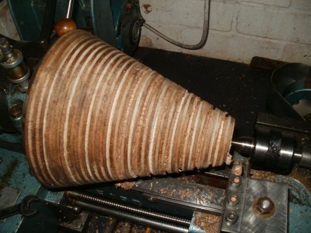

I am currently bending the tube (3/16" OD Cunifer brake pipe) which is going to be arranged in 4 layers in a cone shape, here is a former I have made to bend the tube around.
