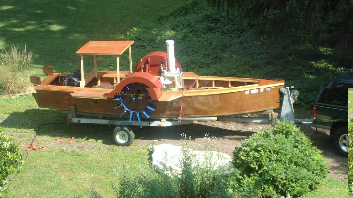

My boat also has no thru-hull connections whatsoever, so when I clean up the bilges an ordinary shop vacuum is used to suck up the water. Cylinder oil and bearing oil that ends up in the bilge and sticks to everything is present. I usually wash off the engine with WD-40, it cuts the thick oil, and leaves a light protective coating as well, then I wipe all the machinery down with a WD-40 soaked rag.
I had tried all kinds of detergents and cleanars to clean up the bilge, usually with poor results, until someone at a steamboat meet recommenced "Simple Green" which is available at most US supermarkets, etc. Simple Green works very well at getting the oil off everything, bilges cleaner than ever. Spray it onto the oil laden surfaces, let it sit for a few minutes, then rinse it off. The entire interior of my hull is epoxy coated, and thus protected from most oils and chemicals. I don't know how well Simple Green would work on an uncoated wood surfaces, but it is probably OK there too.
The only thing that I know of that could do a better job is a live steam lance (or a hot high pressure washer), however these couild easily damage to fiberglass-epoxy coating on the interior (and exterior) of my boat, and can take paint off surfaces frequently.

- Sidewheeler about to be washed, Shpo Vacuum in stern
- SW VIEW.jpg (98.14 KiB) Viewed 11470 times
