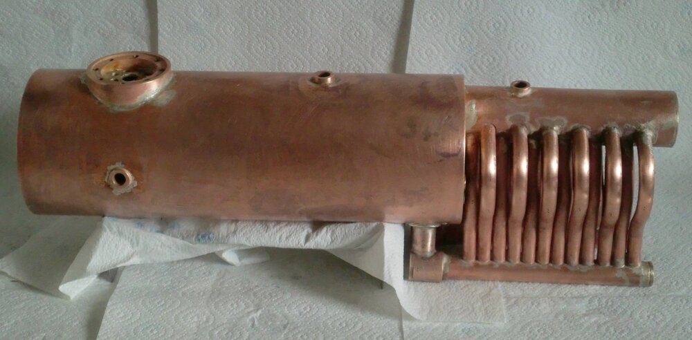

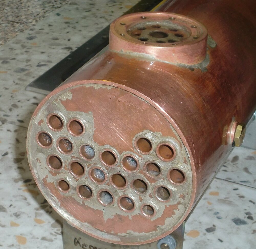

the BROTAN design is very interesting and fascinating, but somewhat challenging to build. I built one for a 5" (1:11) steam locomotive. The steam production is excellent, but the operation is rather demanding.
The smoke chamber tube wall
Overall view of the boiler
Posts: 576
Re: Hello from Florida
Thanks for posting the photos Dietrich. That is a beautiful piece of work. I admire your ability to silver solder so neatly - I need some lessons on that skill. The design is not one I have ever seen before. Did it get used in 'full sized' locomotives or other applications?
