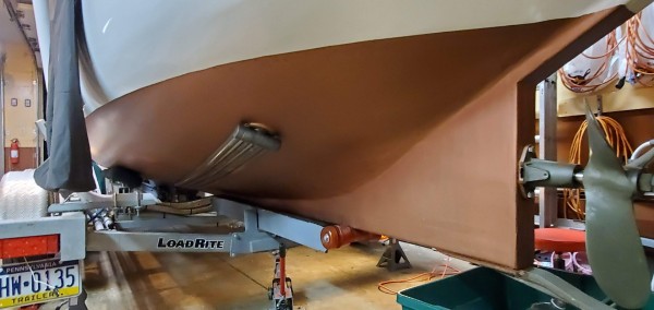

Tradeoffs for me, on both my 25' steam launch and my 25' "Pocket Trawler", have been between not having the rudder lower bearing drag on the ground when going over curbs in such things as gas stations, v.s having the boat up higher from the ground and drowning my tow vehicle brakes on launch ramps.
My compromise is to have a tongue extension on the trailer so I can keep my trailer further away from the truck. A bunch of extra fussing particularly when there is ramp congestion!

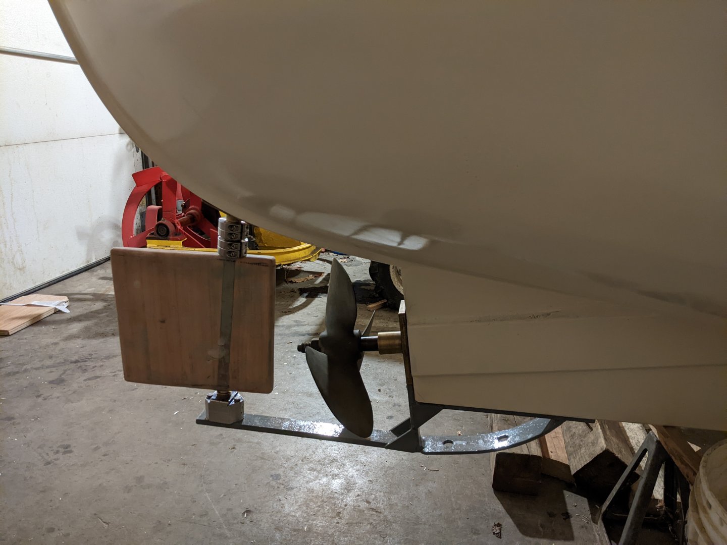

I see that your rudder bottom bearing has an extension to reach the strap. You may find that bending that strap up closer to the bottom of the rudder is worthwhile when towing over curbs and the like.
