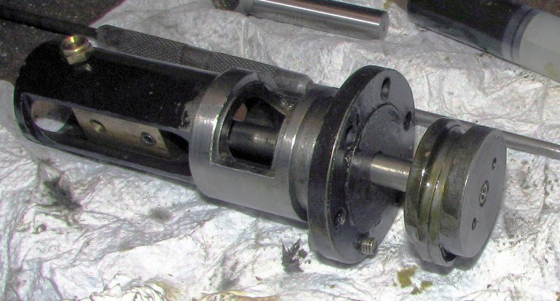

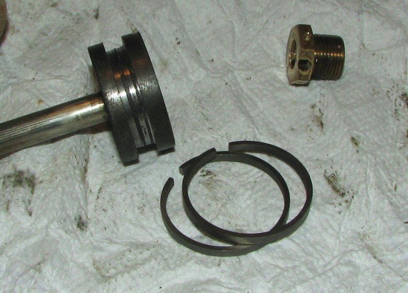

unfortunately I don't know the context in which you work, so it's difficult to give good advice. I have used gray cast iron piston rings from engine construction in all of my current steam engines. But because they have a small gap at the joint, I use two pieces in a groove that are offset by 180° from each other. Because the piston ring groove was too deep for the new piston rings, I made a splited filler ring (not shown).
Here are two pictures of how I did it on my MARTIN steam lorry.
