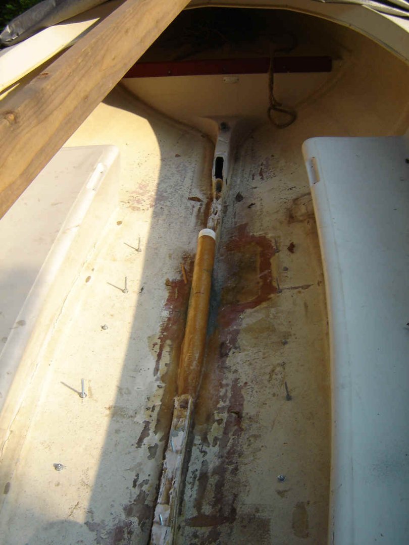

The Javelin hull I converted originally used an electric motor, however the modifications to convert it to a propeller driven boat would work as well with steam power (indeed, I now have a rather large steam plant in this hull). The photo shows the PVC pipe encased with fiberglass cloth and automotive repair resin. The orientation of the PVC propeller tube is set according to where the engine/boiler will be located, and tilted about 10 to 15 degrees from horizontal is typical.
Sand or grind the original fiberglass hull where you want the new fiberglass / resin to bond properly. Wear a mask as the dust is nasty. Wear protective gloves when mixing and applying the new fiberglass / resin.

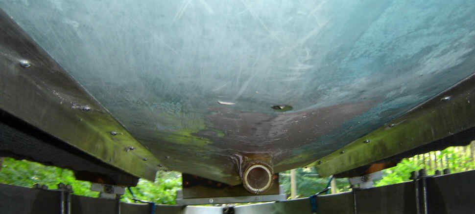

With the centerboard removed,the sailboat hull needs to have "bilge keels" added to provide proper steering stability. I used aluminium angles, 2 inches x 2 inches x 1/8 inch thick, each 8 feet long. The aluminum angles are bolted through the fiberglass hull, with suitable silicone caulking to seal the aluminum to the hull.
- keels-sterntube-look fwd.jpg (46.55 KiB) Viewed 27998 times

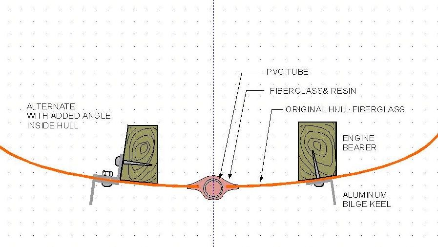

Inside the hull, on the previous photograph, notice the bolts that secure the bilge keels. These bolts will also secure two long wood engine/boiler bearers, and form the foundation for the interior floor. The sketch here is a cross section drawing of the hull, illustrating the fabrication:

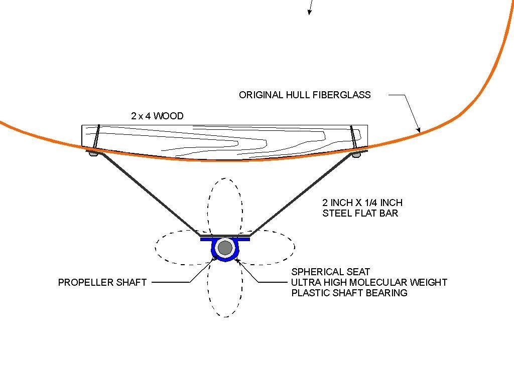

The propeller shaft will exit the PVC tube for some distance, and requires a bearing just before the propeller is fitted. I made a bearing support from a piece of steel flat bar, and the actual bearing is a food service UHMW plastic material, fitted in a stainless steel spherical mount. When I made this the UHMW bearing, for a 1 inch diameter shaft cost about $20.
The mounting is shown in the attached drawing, secured similar to the engine bearers. This arrangement has functioned well for 17 years, running several years with electric motor drive, then with a 13 horsepower IC engine, and now finally with a new steam plant. A 14 x 17 propeller was fitted to my Javelin, and has endured several groundings. The clearance between the hull and propeller needs to be 10-15% of the propeller diameter.
- JAV-BRG.JPG (64.98 KiB) Viewed 27986 times

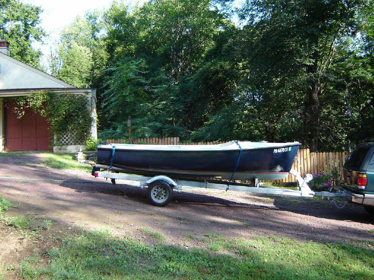

So there you have it, $107 cost on ebay, converted to a propeller drive boat with well under 2 weeks spare time work, with two cans of Krylon spray paint, still excellent after 17 years.
