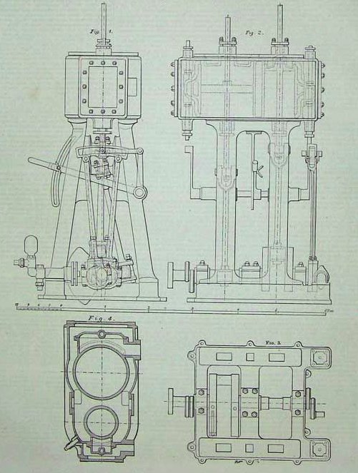

Boiler feed pump ?

Here a crank driven feed pump (Steam launch "Bell Bird" 1876).
The crank is at the outside excenter.
