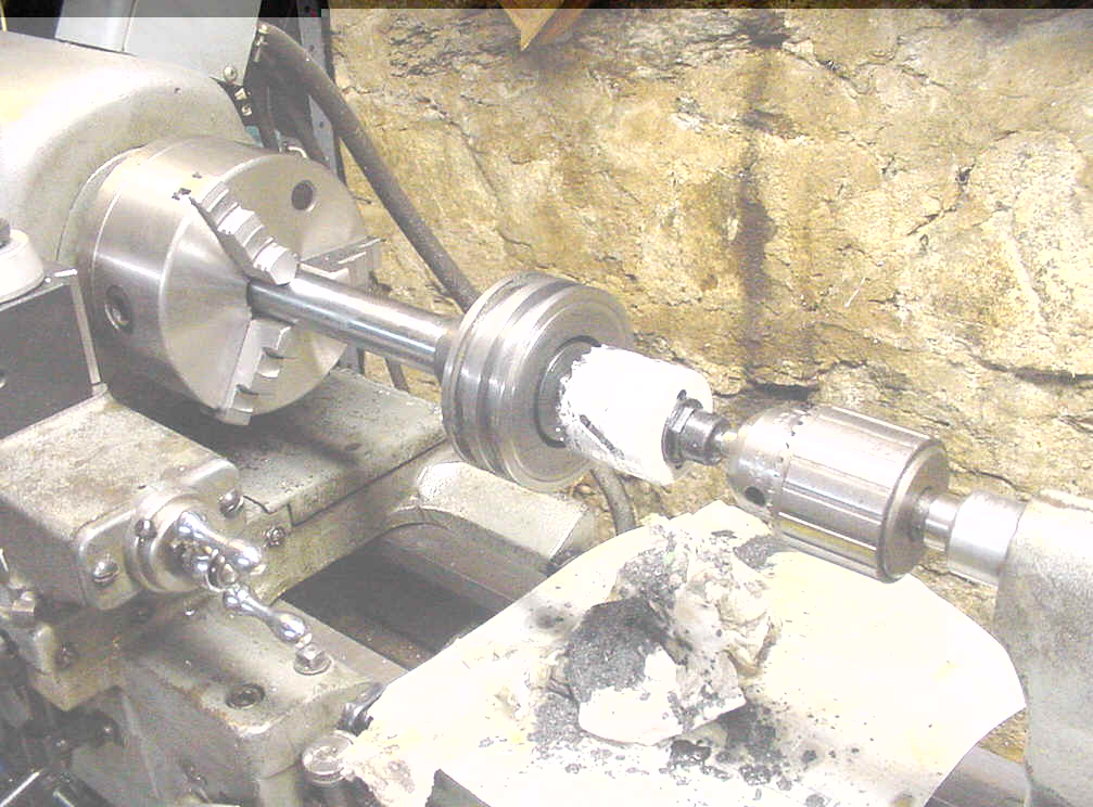

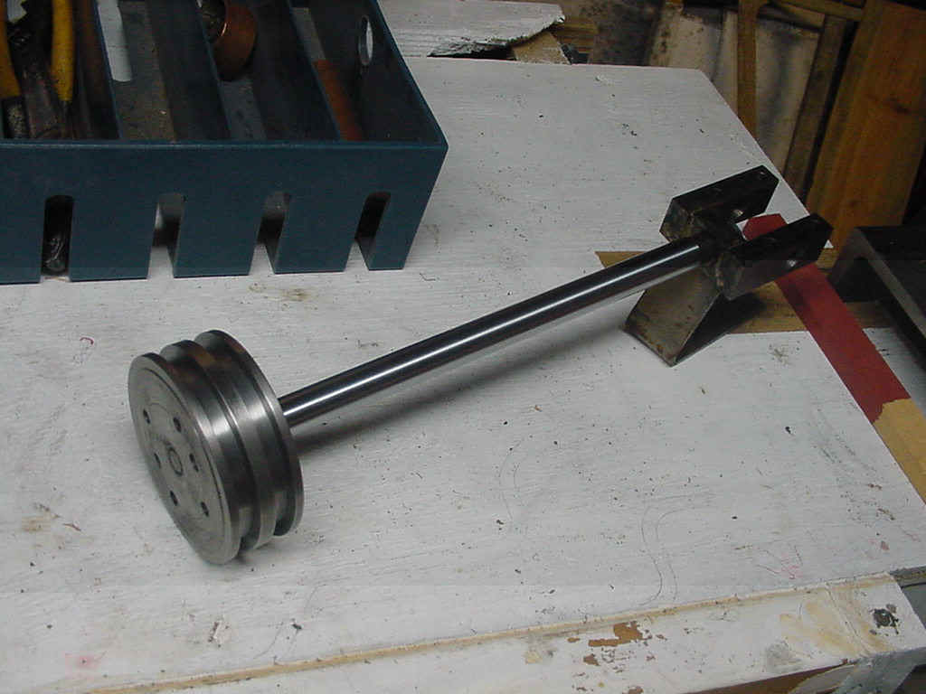

Make piston/piston rod assemblies from hydraulic and air cylinders. 3.25 inch industrial hydraulic cylinder being used for steam, had a big (1-1/4 inch diameter piston rod, way too big), but I only needed 5/8 dia rod. Drill big piston, then machine piston from a smaller cylinder with 5/8 rod. Press together and lock with "poor boy" keys.
The cylinders are available with hard chrome rods and hard chrome cylinder bores, much better than I can make in my shop, and only a few dollars on e-bay. This piston & rod has been in service for four years now, have never re-packed stuffing box, good allignment plus the hard chrome makes for a long lasting setup.
Get the manufacturer's catalogues online, so you can see how model numbers describe the cylinder's fearures (I got 3-1/4 inch hydraulic cylinder with special industrial hi-temp iron stepped rings rather than elastomeric piston seals). Then troll on ebay, what you want will eventually show up, at 10% of the price for a new retail cylinder.

- Drilling big piston for removal from big diameter rod
- CUT PISTON.jpg (95.47 KiB) Viewed 6083 times
- Completed assembly, 3.25 bore, 5/8 rod
- 3-25PistonAssy.jpg (58.2 KiB) Viewed 6083 times
